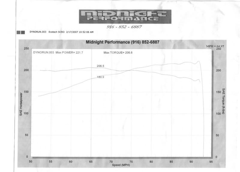

    Here's my dyno sheet. Red is with the factory intake setup, blue is with a straight intake. A few observations:
    • The factory Ariel intake is TERRIBLE. I picked up 14hp *untuned* with a straight intake with a bevel on it, and at least 500rpm of powerband. I'll be fabbing a 3" intake under the driver side shock with a good filter and sock.
    • The factory header is TERRIBLE. I'll be getting another header built over the winter and should pick up ~20hp.
    • These numbers are for a basic, safe tune. There is probably 5-10hp more in it with timing and fine tuning across the powerband; however, I did want to spend 6 hours getting the tune perfect and then redo the intake and exhaust.
    • I'm quite happy with the numbers. The car will outrun my supercharged viper, and it would take a 150 shot or more on my 383 z06 to run with it. It's spooky fast.
    • Well built motors > superchargers on stock blocks
    For reference, here's a stock AA2 Honda 300 dyno and a Brammo dyno run:

    Good solid NA numbers
    Very nice!
    rotrex that son of a bitch!
    Quote Originally Posted by silver View Post
    Not at 12.5:1 compression... not without 116 Octane.
    With different slugs this motor could easily make 600rwhp. I'd probably destroke it with a F22 crank though and spin it to 10k just for grins.
    Let me figure out how to not dead myself with 300rwhp, and then we'll turn up the wick.
    Jason
    yeah I know
    but the rotrex sounds like a jet engine......seriously stiff wood there.
