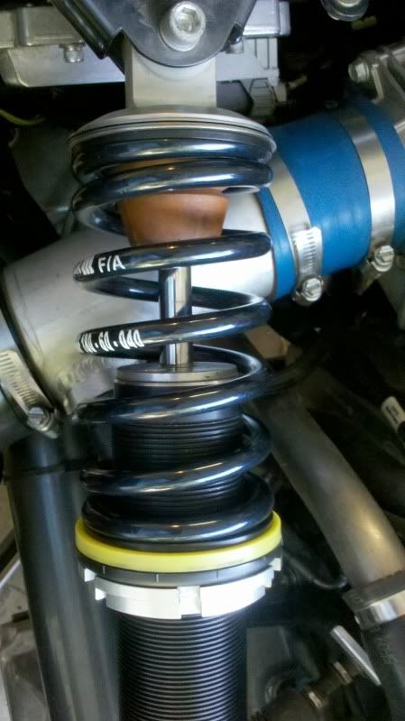

    FRONT SHOCK
    the front shock only has 1 vorshlag bearing I located the bearing where I did so that the spring would retain it's perch at the top and not lose it at the bottom, this addition allows the top of the shock to turn about 1/4 turn each way uninhibited. On the front and the back I added nylon washers to prevent the roller rocker from digging into the shock body any further.

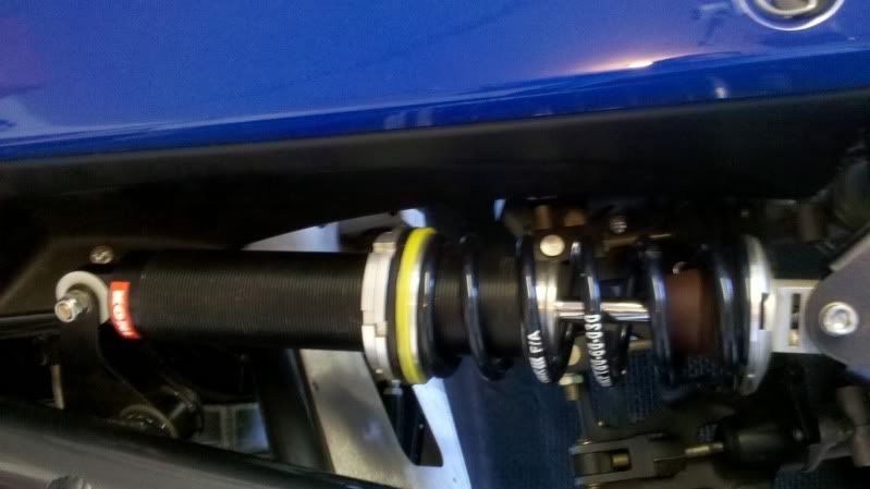

    The rear shock
    At the top of the rear shock I kept the original unsealed bearings installed and added the vorshlag bearing to the bottom perch. If I put the thicker bearing at the top, the spring has no perch so I decided to put it at the bottom where the perch is retained. Also, I could have added the perch left over from removing the helper spring BUT, on mine the thickness of the helper spring perch plus the regular perch is thicker than the bearing, making it not possible.

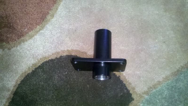

    This is what I'm calling the steering box
    this is what the bearing should be pressed into, but on mine the mechanic previously pressed the bushing on to this

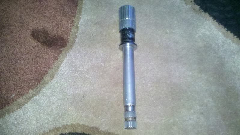

    Spanky cut down a bit of the bushing, and was able to pound it off the steering shaft, it took enough force he was worried it would break but it didn't.

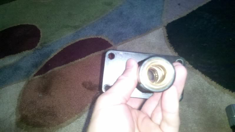

    At this point the steering shaft is too thick to fit into the new bushing which has been pressed into the steering box.
    Spanky had given me a 2 piece bushing which allows the middle 1 inch or so of the steering column to remain untouched inside the steering box, which basically helps reduce friction.
    I started to sand down the steering column, I started with 500 grit, wet, then after 30 minutes moved to 150 grit, then 20 more minutes, without progress, I checked the fit every 2 to 3 minutes to be sure I wasn't taking too much off. I then went to 80 grit and finally 60 grit before I could reduce enough material to make a difference.
    When I started using the 60 grit I made quick progress, again checking for fit every few minutes, once I was happy with the fit, I cleaned it up all the way to 500 grit, here's what it looked like
    Per Spanky's directions I added a lot of grease to the inside of the bushing, and packed it full, then added some to the steering column and slit it together and cleaned up the excess.

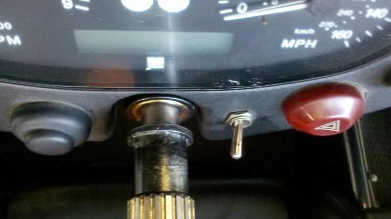

    I reinstalled everything together, and one interesting note, the top 2 bolts for the steering box also mount the dash...I can't think this is the smartest thing b/c you're putting a lot of force on the dash plastic as you tighen down the bolts to the steering box.
    it all went back together very easily. Spanky has recommended that I add a nylon bushing between the steering box and the shoulders of the steering column...because brammo didn't make the steering box the correct length there is just under 1/4 inch exposed of the column...this matters b/c you could potentially push too hard on the steering wheel and sheer off the set screws on the first U joint. Not likely but better safe than sorry. So now that it's all together I can measure the thickness I need and go buy one.
    Here's a pic of the spacing that should be taken up by the nylon bushing
