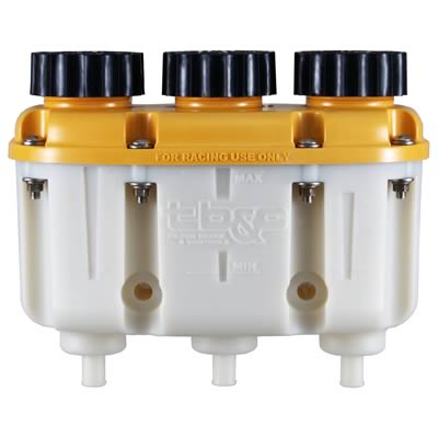

    So I've had #66 for a couple weeks and noticed a leak from the furthest right white reservoir tank (not the washer fluid) onto the floorboard. I am told it is the rear brake fluid tank. Anyone have this issue before and what was the fix? I tried tightening the clamp, but 48 hrs later, still drips on floorboard but not as much.

    Im not sure if anyone hasnt had a brake fluid leak. Here is how I fixed mine:
    My leak was from the connection between the top and bottom sections (This is tilton reservoirs ). But after positioning the band better it does not leak anymore. "A" was slipped down into grove "B" You can also see the faint black O ring inside, between the to ties. That o ring has to be between them to seal
    a few people have purchased this much better designed all in one part. But this would require re-bleeding everything
    http://www.summitracing.com/parts/TIL-72-576/?rtype=10

    "But this would require re-bleeding everything" Actually,untrue. If you are careful and don't allow the brake fluid to drain from the hoses,the swap can be performed with NO bleeding necessary.

    Clamps looked like they were on correctly. I am wondering if the seal on a cap might be bad, so I switched caps. I guess we will see.

    Eventually,the plastic clamped to the plastic will leak,again.It is the law of Tupperware!
