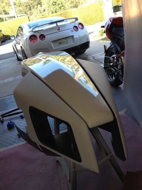

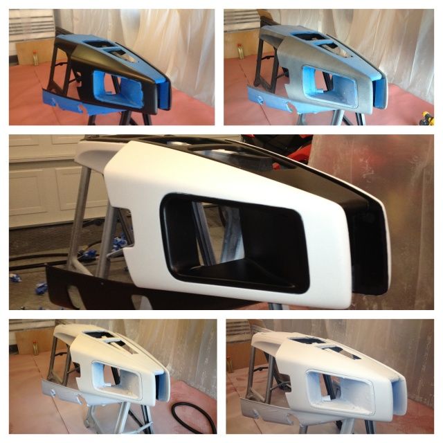

    So I purchased a AA3 black on black on black, which I love but I can not keep cars clean so I always opt for white. being that I don't see the Atom staying in my life forever (this is because of limit garage space) I want to keep the factory color. so first I wrapped in vinyl but the contours caused the vinyl to keep lifting, next option dipyourcar its basically plastidip yup I said plastidip the crap you find at home depot
    here are some pics... let me know your thoughts. my idea was when I sell it could be taken off and sold as the original black Atom.

    it's been the talk on the GTR forum for a bit. I figured for $300. which includes the spray gun 3 gallons of dip and a roll of blue tape it would be worth the try. here is the problem I found. "Masking" when you watch videos they make it seem super simple and it peels at the point of the mask, not true I had to sit and razor most of the masked areas which is why I'm not too happy nor do I have the straightest lines. second thing is they said (and this could be the masking problem as well) that a full size car should take no more than 5 coats of dip therefor 3 gallons is plenty well.. I had to use 1 full gallon just on the front nose, they claim this is because the flat black is hard to cover which is true I did 9 coats and still see some areas I'm not thrilled about. which brings on the next problem and the main reason I decided on this product. Being the Atom has many different contours its hard to wrap with vinyl therefore we got lots of lifting, well same goes for the dip. the most important part of the dip is to have consistent coverage which crazy bumps grooves and contours are hard to get, of corse I am not a painter my any stretch of the imagination it was just a pain in the arse.
    Over all I'm happy because it was a cheap fix to my white Atom craving, but I will paint if I decide to keep this beast.
    A few things I should mention the product does peel off as advertised however peeling has more success with the more coats applied, if you have lets say 1 or 2 coats it doesn't peel its more of a rub off in some cases you need to use more than your finger.
    Im in middle of super charging once I'm done I will post pics of the dipped Atom
    Just my opinion but this was a cheap fix for color. lastly most guys are using this for daily driven cars and wear and tear seems decent one guy said he's been dipped for a year including the wheels with no problems. A few guys are also using this product for long distance driving and track day paint chipping protection.
